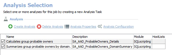

Navigate to the Jobs > Entra ID > 1.Groups > AAD_ProbableOwners > Configure node and select Analysis to view the analysis tasks.
Analysis tasks for AAD_ProbableOwners Job
  • Calculates group probable owners – Creates the AAD_ProbableOwners_Details table accessible under the job’s Results node
  • Summarizes group probable owners by domain – Creates the AAD_ProbableOwners_DomainSummary table accessible under the job’s Results node
