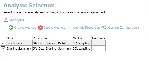

Navigate to Box > 1.Activity > Forensics > Box_Sharing > Configure node and select Analysis.
Analysis Tasks for the Box_Sharing Job
  • Box Sharing – Creates the Box_Sharing_Details table accessible under the job’s Results node
  • Sharing Summary – Creates an interim processing table in the database for use by downstream analysis and report generation
