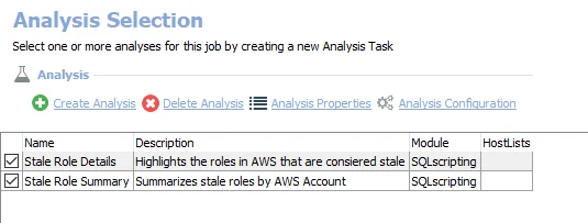

Navigate to the AWS > 4.Roles > AWS_StaleRoles > Configure node and select Analysis to view the analysis tasks.
Don't deselect the selected analysis tasks. The analysis tasks are preconfigured for this job. Only modify the analysis tasks listed in the customizable analysis tasks section.
Stale Role Details – Highlights the roles in AWS that are considered stale. Creates the AWS_StaleRole_Details table accessible under the job’s Results node.
- The number of days without log in to consider an account stale can be customized. By default it is set to 60. See the Customizable Analysis Tasks for the AWS_StaleRoles Job topic for additional information.
Stale Role Summary – Summarizes stale roles by AWS Account. Creates the AWS_StaleRole_Summary table accessible under the job’s Results node.
