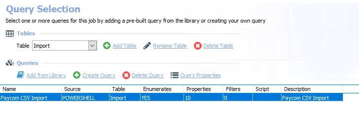

Step 1 – Navigate to the AnyID Connectors > AnyID_Paycom > Configure node and select Queries.
Step 2 – In the Query Selection view, select the Paycom CSV Import query and click Query Properties. The Query Properties window opens.

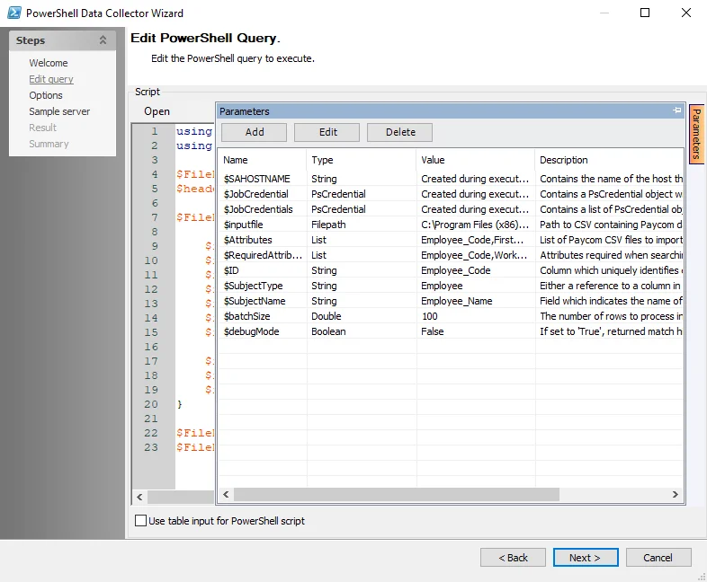

Step 3 – Select the Data Source tab, and click Configure. The PowerShell Data Collector Wizard opens.
Edit Query Page
Step 4 – Navigate to the Edit Query page. Click the Parameters tab on the right-hand side of the page to expand the Parameters window. See the PowerShell: Edit Query topic for additional information. Configure the following attributes as needed:
  • $SAHOSTNAME – Created during execution. This parameter can't be modified.
  • $JobCredential – Created during execution. This parameter can't be modified.
  • $JobCredentials – Created during execution. This parameter can't be modified.
  • $inputfile – File path to the CSV file which contains the identity and attribute information
  • $Attributes – The list of attributes that will be scanned for during sensitive data scanning
    • An attribute in the Attributes list will not be considered a match (in reporting and AIC) unless an attribute in the RequiredAttributes list is also found in the same file
  • $RequiredAttributes – The list of attributes that need to be found in the document to trigger a match
  • $ID – Column which uniquely identifies each subject
  • $SubjectType – Either a reference to a column in the csv file or a string which indicates the type of subjects being imported
  • $SubjectName – Either a reference to a column in the csv file or a string which indicates the name of the subjects being imported
  • $batchSize – The number of rows to process in a batch. Leave at default unless otherwise required.
  • $debugMode – When set to true, stores unhashed attribute values for troubleshooting purposes
Step 5 – Click Next. Continue to the Sample server page and click Finish to save changes. Click Cancel to exit the wizard without saving changes.

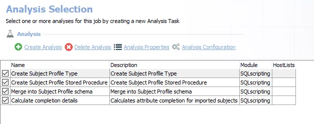

Analysis Tasks for the AnyID_Paycom Job
Navigate to the Jobs > AnyID Connectors > AnyID_Paycom > Configure node and select Analysis to view the analysis tasks.
  • Create Subject Profile Types – Creates subject profile types
  • Create Subject Profile Stored Procedure – Creates subject profile stored procedure
  • Merge into Subject Profile schema – Merges into subject profile schema
  • Calculate completion details – Calculates attribute completion for imported subjects
