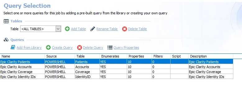

Configure the AnyID_EpicClarity Queries
To configure the AnyID_EpicClarity queries:
Step 1 – Navigate to the AnyID Connectors > AnyID_EpicClarityConfigure node and select Queries.
Step 2 – In the Query Selection view, select a query and click Query Properties. The Query Properties window opens.

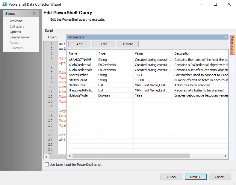

Step 3 – Select the Data Source tab, and click Configure. The PowerShell Data Collector Wizard opens.
Edit Query Page
Step 4 – Navigate to the Edit Query page. Click the Parameters tab on the right-hand side of the page to expand the Parameters window. See the PowerShell: Edit Query topic for additional information. Configure the following attributes as needed:
  • $portNumber – The port number used to access the Oracle Database Server
  • $fetchCount – The number of rows to process in a batch. Leave at default unless otherwise required.
  • $Attributes – The list of attributes that will be scanned for during sensitive data scanning. Default values are MRN, SSN, Name, Date of Birth, Subscriber ID, Identity ID, and Account ID.
    • An attribute in the Attributes list will not be considered a match (in reporting and AIC) unless an attribute in the RequiredAttributes list is also found in the same file
  • $RequiredAttributes – The list of attributes that need to be found in the document to trigger a match. The default values are SSN, MRN, and IdentityID.
  • $debugMode – When set to true, stores unhashed attribute values for troubleshooting purposes
Step 5 – Click Next. Continue to the Sample server page and click Finish to save changes. Click Cancel to exit the wizard without saving changes.
Repeat these steps for each query in the case that a non default port value is required. Once completed, the queries are ready to run.

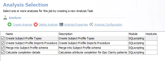

Analysis Tasks for the AnyID_EpicClarity Job
Navigate to the Jobs > AnyID Connectors > AnyID_EpicClarity > Configure node and select Analysis to view the analysis tasks.
  • Create Subject Profile Types – Create subject profile types
  • Create Subject Profile Imports Procedure – Create subject profile imports procedure
  • Merge into Subject Profile schema – Merge into Subject Profile schema
  • Calculate completion details – Calculates attribute completion for Epic Clarity patients
