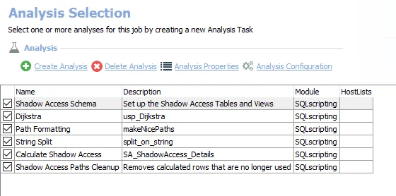

Analysis Tasks for the AD_ShadowAccess Job
Navigate to the Active Directory Permissions Analyzer > AD_ShadowAccess > Configure node and select Analysis to view the analysis tasks.
Don't modify or deselect the selected analysis tasks, with the exception of the Calculate Shadow Access analysis tasks. The analysis tasks are preconfigured for this job. The Calculate Shadow Access analysis task is the only analysis task that has customizable parameters.
  • Shadow Access Schema – Sets up the Shadow Access Tables and Views
  • Dijkstra – Creates an interim processing table in the database for use by downstream analysis and report generation
  • Path Formatting – Creates an interim processing table in the database for use by downstream analysis and report generation
  • String Split – Creates an interim processing table in the database for use by downstream analysis and report generation
  • Calculate Shadow Access – Creates the SA_ShadowAccess_Details table accessible under the job’s Results node
  • Shadow Access Paths Cleanup – Removes calculated rows that are no longer used

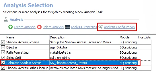

Step 1 – Navigate to the Active Directory Permissions Analyzer > AD_ShadowAccess > Configure node and select Analysis to view analysis tasks.
Configure Calculate Shadow Access task from Analysis Selection view
Step 2 – In the Analysis Selection view, select the Calculate Shadow Access analysis task, then click Analysis Configuration. The SQL Script Editor opens.

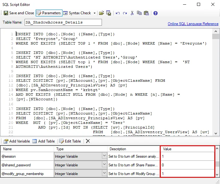

SQL Script Editor
Step 3 – In the parameters section at the bottom of the editor, find the Value column. Double-click the current value and change as desired.
  • If the variable type is a table, select the cell and click Edit Table to modify the value.
Don't change any parameters where the Value states Created during execution.
Step 4 – Click Save and Close to finalize the customization and close the SQL Script Editor window.

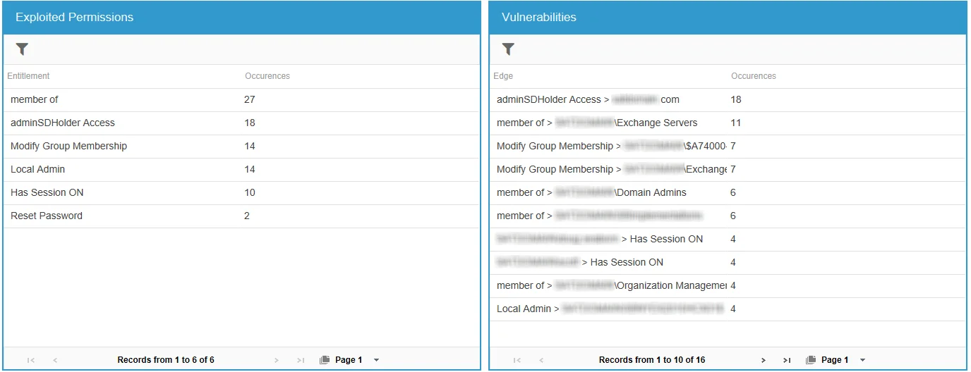

Exploited Permissions and Vulnerabilities on Shadow Access reports
The Domain Shadow Access and Sensitive Data Shadow Access reports provide information on the exploited permissions and vulnerabilities that can be used as attack paths for shadow access to domain and sensitive data.
  • Exploited Permissions – Displays summary information of the types of permissions that can be exploited by shadow attacks and the number of occurrences of those permissions
  • Vulnerabilities – Displays summary information of the vulnerabilities that were detected and the number of occurrences of those vulnerabilities

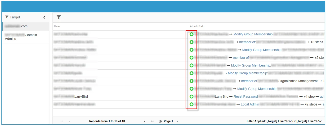

Report element displaying information on potential attack paths for users found in the targeted domain
The last report element displays information on potential attack paths for users found in the targeted domain. Click the green plus sign next to an attack path to open an Attack Path window that displays a step-by-step process of how an attacker can use a compromised user object to conduct a shadow attack.
Attack Path window example
The Attack Path window displays how a user object can be used in a shadow attack.
