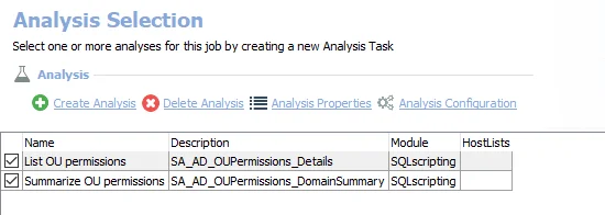

Analysis Tasks for the AD_OUPermissions Job
Navigate to the Active Directory Permissions Analyzer > 3.OUs > AD_OUPermissions > Configure node and select Analysis to view the analysis tasks.
  • List OU permissions – Creates the SA_AD_OUPermissions_Details table accessible under the job’s Results node
  • Summarize OU permissions – Creates an interim processing table in the database for use by downstream analysis and report generation
