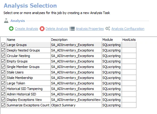

Analysis Tasks for the 3-AD_Exceptions Job
View the analysis tasks by navigating to the .Active Directory Inventory > 3-AD_Exceptions > Configure node and select Analysis. You can modify analysis tasks whose configuration parameters define their security concerns.
  • Large Groups
    • Identifies groups that exceeded the defined threshold for effective group membership
    • Populates processing tables in the database for use by downstream analysis and report generation
    • Definition of a large group can be customized
  • Deeply Nested Groups
    • Identifies groups that exceeded the defined threshold of deep levels of membership nesting
    • Definition of a deeply nested group can be customized
  • Circular Nesting
    • Identifies groups with circular references in their effective membership
  • Empty Groups
    • Identifies groups with no membership
  • Single Member Groups
    • Identifies groups with a single direct member
  • Stale Users
    • Identifies user accounts that are expired, are disabled, or have exceeded the defined threshold of inactivity
    • Definition of a stale user can be customized
  • Stale Membership
    • Identifies groups with a high percentage of effective members that are stale users
    • Definition of stale membership can be customized
  • Large Token
    • Identifies users that exceeded the defined threshold for effective membership in authorization groups
    • Definition of a large token can be customized
  • Historical SID Tampering
    • Identifies users that have a historical SID from their current domain
  • Admin Historical SID
    • Identifies users that have a historical SID from an administrator account
    • Definition of an administrator group can be customized
  • Display Exceptions View – Creates the SA_ADInventory_ExceptionsView accessible under the job’s Results node
  • Summarize Exceptions Count – Generates data used in the Exceptions report
