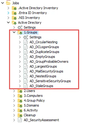

1.Groups Job Group in the Jobs Tree
The following jobs comprise the 1.Groups Job Group:
