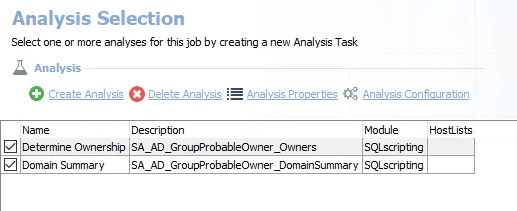

Analysis Tasks for the AD_GroupProbableOwners Job
Navigate to the Active Directory > 1.Groups > AD_GroupProbableOwners > Configure node and select Analysis to view the analysis tasks.
  • Determine Ownership – Creates the SA_AD_GroupProbableOwner_Owners table accessible under the job’s Results node
  • Domain Summary – Creates an interim processing table in the database for use by downstream analysis and report generation
