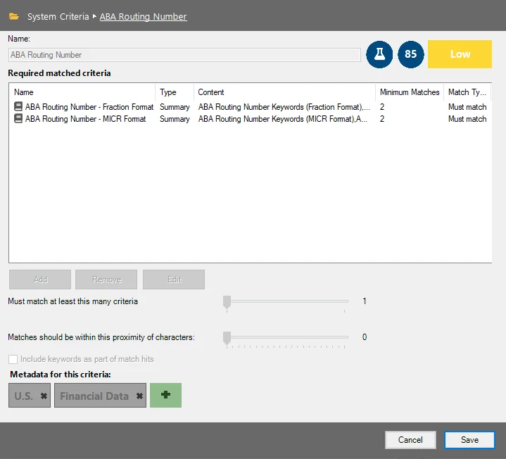

Configuration Pane
Use the configuration pane to view sub-criteria information for System Criteria and to view, add, edit, and remove sub-criteria information for User Criteria.
Configuration Pane
The information in the configuration pane changes based on the criteria selected in the navigation pane.

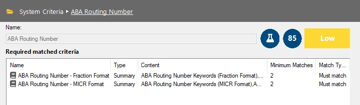

Options at the top of the configuration pane
The options at the top of the Configuration Pane are:
Configuration settings for System Criteria can't be modified.
  • Navigation Path – Displays information on the current location within the Sensitive Data Criteria Editor
  • Name – Name of the criteria as it is shown in the navigation pane
  • Test Criteria Button – Opens the Criteria Tester window to test current criteria configurations. See the Criteria Tester Window topic for additional information.
  • Confidence Level – Displays the current confidence level which indicates how accurate a match is for a criteria
    • The confidence level is reported on a scale from 0 - 100. The closer the number is to 100, the more accurate a match is for a criteria.
  • Risk Score – Displays the general level of risk a criteria represents when found in a file that is not properly secured
    • The risk score can be set to Low, Medium, or High
    • Click the Risk Score button to change the risk score for user-configured criteria
  • Required matched criteria list – Lists the sub-criteria configured for the selected top-level criteria in the navigation pane. The columns in the table are:
    • Name – Name of the sub-criteria
    • Type – Type of sub-criteria: Keywords, Regex, or Summary
    • Content – Values associated with the sub-criteria
    • Minimum Matches – Minimum number of match hits required for a sub-criteria match hit
    • Match Type – Displays whether the sub-criteria Must match or Must not match

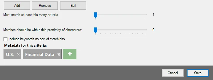

Options at the bottom of the configuration pane
The options at the bottom of the configuration pane are:
  • Add – Add a sub-criteria to the required matched criteria list. The three types of sub-criteria that can be added are Keyword, Pattern, and Summary. See the following topics for additional information:
  • Remove – Remove sub-criteria from the Required matched sub-criteria list
  • Edit – Edit the selected sub-criteria
  • Must match at least this many criteria – Adjust the slider to configure how many sub-criteria must be matched for the sensitive data criteria to be reported
    • The minimum value is 1
    • The maximum value is the number of sensitive data sub-criteria that has been added to the required matched criteria list
    The character distance feature doesn't account for summaries that are nested within other summaries.
  • Matches should be within this proximity of characters – Match hits for this criteria should be within this many characters of one another for a match to occur. Adjust the slider to set the default character distance required for match hits.
    • The minimum value is 0
    • The maximum value is 200
    • Using this feature requires any combination of two or more Regular Expression (Pattern) and Keyword sub-criteria
  • Include keywords as part of match hits – Select this option to include keywords as part of match hits. This option determines whether a match found based on a Keyword Criteria is reported as a match hit. When this option is selected, any matches found for a word in the Keyword list is reported as match hit. If this option isn't selected, then only matches found based on Pattern or child Summary Criteria are reported as a match hit.
  • Metadata for this criteria – Click the green plus (+) button to add a new metadata type for the criteria. Delete a metadata type by clicking the X button in the gray metadata tag.
  • Cancel – Exit the Sensitive Data Criteria Editor without saving changes
  • Save – Save changes made to the current criteria
