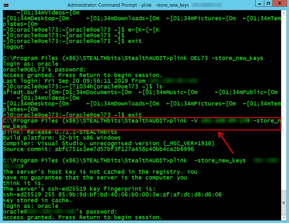

In case of Linux and UNIX hosts, the plink command needs to be executed on the Enterprise Auditor Console server to update the local file with the SSH keys.
NOTE: The plink utility in the Enterprise Auditor installation directory has to be used. A version of plink gets installed with the Nmap utility.
The syntax is as follows:
administratorcommandprompt
Run the following on the command prompt:
C:\Program Files (x86)\Stealthbits\StealthAUDIT\plink <hostname>  -store_new_keys
