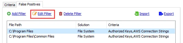

To edit a False Positive Exclusion Filter:
Edit Filter on False Positives tab

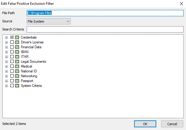

Step 1 – Click Edit Filter to open the Edit False Positive Exclusion Filter window.
Step 2 – Make modifications to the File Path, Source type, and Search Criteria.
Step 3 – Click OK to confirm changes. The Edit False Positive Exclusion Filter window closes.
