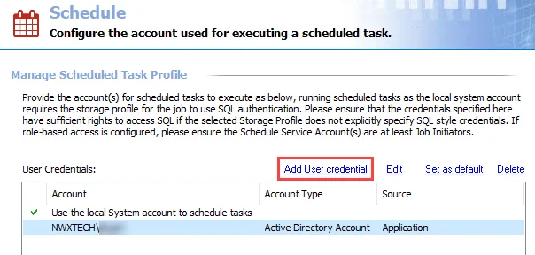

Add User credential option in the Schedule view
Step 1 – Click Add User credential at the top of the Schedule view. The User Credentials window opens.

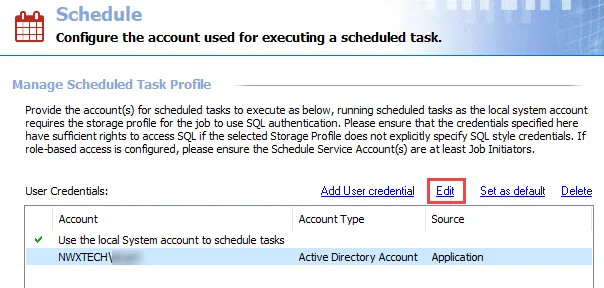

Edit option in the Schedule view

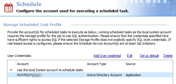

Step 1 – Select a credential from the User Credentials list and click Edit. The User Credentials window opens.
Step 2 – Modify the credential information as needed. See Step 2 of the Create a Schedule Service Account topic for additional information.

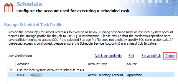

Delete option in the Schedule view
Step 1 – Select the credential from the User Credentials list and click Delete. The Delete Credentials confirmation window appears.

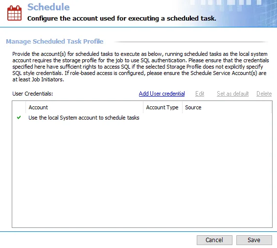

If you remove all Schedule Service Accounts and only the local System account remains, Enterprise Auditor can't create or run scheduled tasks unless the local system account has adequate permissions.
