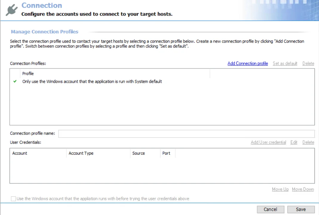

Connection
The Connection node contains objects referred to as Connection Profiles. A Connection Profile houses the information Enterprise Auditor uses to connect to the target hosts during job execution.
Connection
There are two methods for authentication to a targeted host:
  • Use Local Login Credentials
  • Use a Connection Profile

Cancel and Save options
The Cancel and Save buttons are in the lower-right corner of the Connection view. These buttons become enabled when you make modifications to the Connection global setting.
Information update message box
Whenever you make changes at the global level, click Save and then OK to confirm the changes. Otherwise, click Cancel if you don't want to save the changes.
