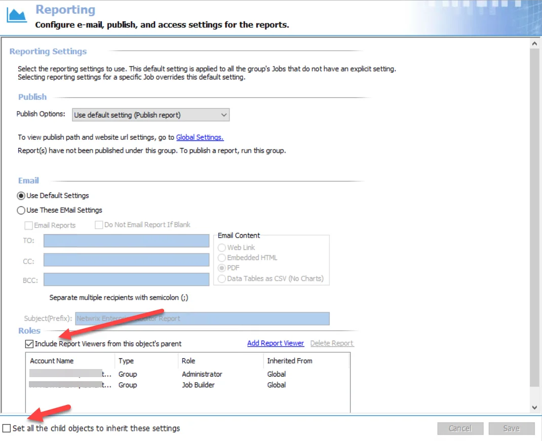

- Assigned at the Job Group level (Jobs > [Job Group] > Settings > Reporting) – Able to view all reports published by the jobs within this job group

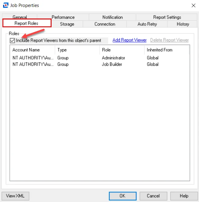

- Assigned at the Job level (Jobs > [Job Group] > [Job] > Job Properties > Report Roles tab) – Able to view all reports published by this job

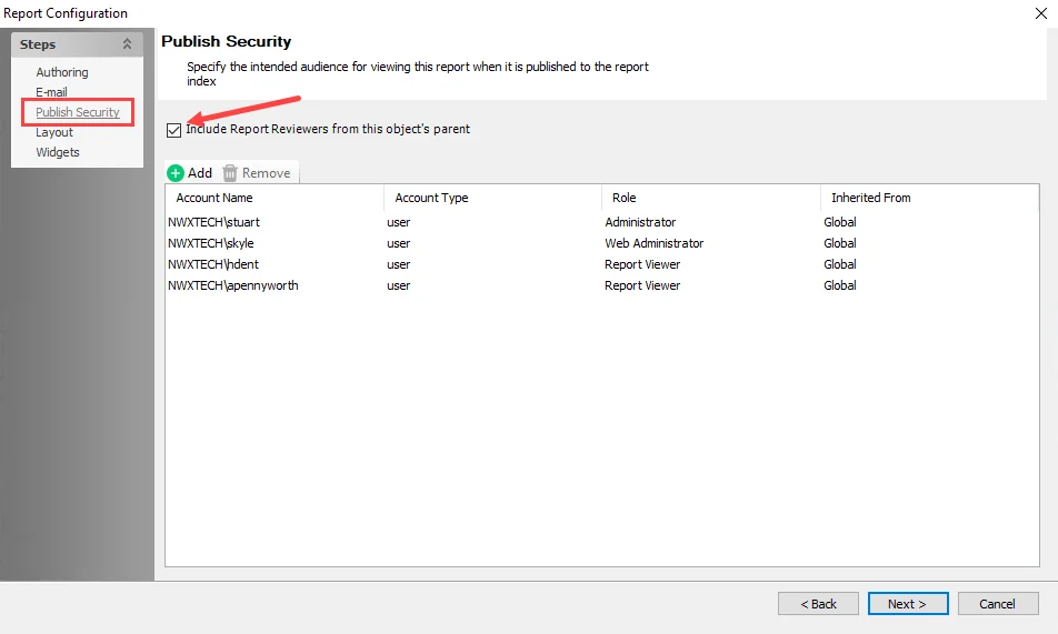

- Assigned at the Report configuration level (Jobs >[Job Group] >[Job] > Configure > Reports> Configure > Publish Security page) – Able to view only this report
By default, many roles have rights to view all reports and report content. You can break the Report Viewer role's inheritance at the job group, job, or report configuration levels. See the Report Viewer Inheritance topic for additional information.

You can assign additional users the Report Viewer role at the global, job group, job, or report configuration levels. Child objects inherit these rights. However, you can break the Report Viewer role's inheritance at any level. Break inheritance to remove the right to view specific reports at:
- Job Group level – [Job Group] >Settings > Reporting node
- Job level – [Job] > Properties >Report Roles tab
- Report Configuration level – [Job] > Configure > Reports node. Click Configure next to the report, and navigate to the Publish Security page of the Report Configuration wizard. See the Publish Security Page topic for additional information.
| Job Group Level | Job Level | Report Configuration Level |
There are two options that control inheritance for Report Viewers when selected:
- Include Report Viewers from this object’s parent – Automatically removes any user with the Report Viewer role inherited from a parent object at the lower levels
- Set all the child objects to inherit these settings – Only available at the Job Group level. Sets all Jobs and Reports to inherit group settings for all child objects by automatically selecting the Include Report Viewers from this object’s parent option. The system overwrites any previous configurations after you select Yes in the confirmation window.
