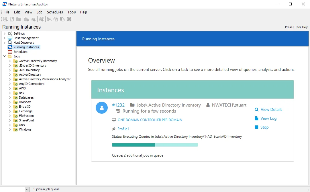

Running Instances node Overview page
This is the primary view of the Running Instances node that displays the progress of all jobs running.
Overview
The Overview page displays information about all running jobs on the current server.
Overview page
For each instance this screen provides :
  • Job path
  • Credential used
  • Running time of the job
  • Status of the running job
  • Number of jobs scheduled in queue
It also has hyperlinks for:
  • Process ID
  • Host Name
  • Connection Profile
  • View Details
  • View Log
  • Stop
  • View Schedule
Clicking on any of the hyperlinks displays more information about the running job. The ProcessID, View Details, View Log, and Stop links only work while the job is running. After the job is complete, these links are disabled. The host and Connection Profile links continue to work. The View Schedule link only displays and is valid for jobs that are running via a scheduled task and isn't enabled for interactive job executions.
Number of jobs running on bottom bar
You can find the number of jobs being run in the lower-left-hand corner of the Enterprise Auditor Console.

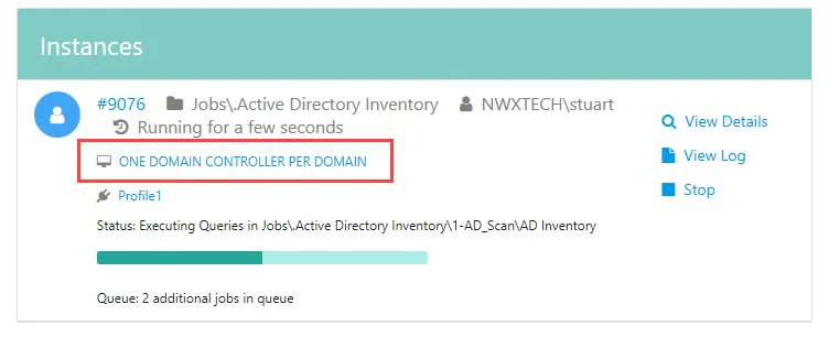

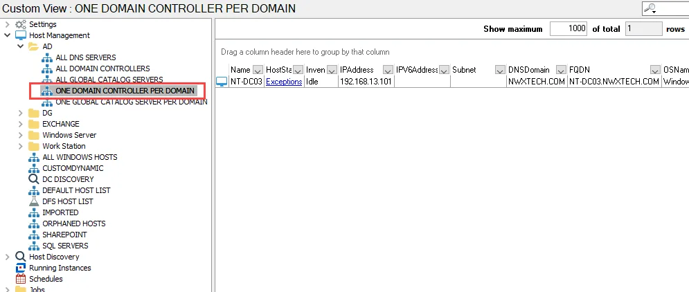

View Host
This view identifies the host list associated with the running job.
Host list link
Click the host list link to display the hosts assigned to the running job.
Host list in Host Management node
This view displays the host list table with host inventory data.

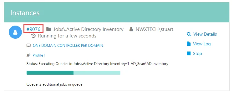

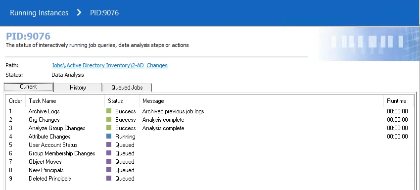

Process ID
The Process ID correlates to the Process ID of the running instance of Enterprise Auditor in Task Manager. In addition, the Process ID comes coupled with the file path of associated scheduled tasks, an identifier for the account running the current instance of Enterprise Auditor, and a timestamp for the length of the instance.
Process ID link
Click the Process ID link for additional details of the job status and queue.
Job details page
The Process ID link displays a page with three tabs of information with details about the running job. See the Running Job Details topic for additional information.

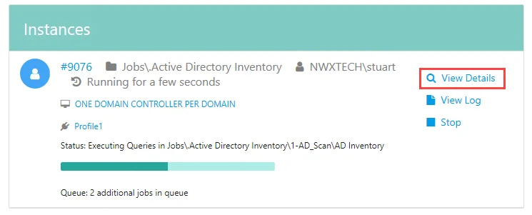

View Details
Additional details on the status of the tasks the job is running are available.
View Details link
Click the View Details link to display additional details of the job status and queue.
Job details page
The View Details link opens the running job's details with three tabs of information. See the Running Job Details topic for additional information.

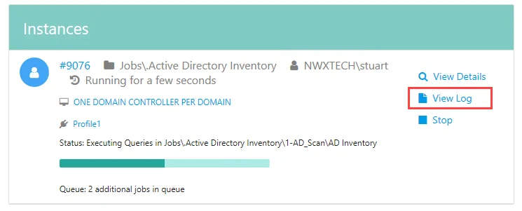

View Log
You can open the log for this running job in a text editor, such as Notepad.
View Log link
Click View Log to display the current job log. The View Log link is only enabled while a job is running.
Log file in Notepad
The Log displays such details as errors, aborts, and terminations.

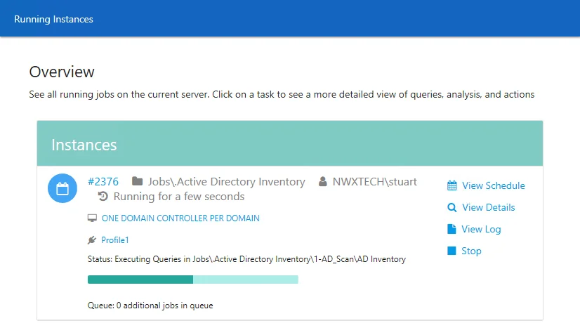

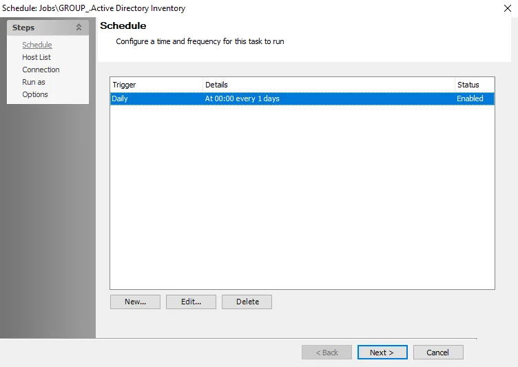

View Schedule
The Enterprise Auditor Console can only run one job at a time. However, with the Schedule Service Account, the StealthAUDIT application can run multiple jobs simultaneously via Windows Task Scheduler.
View Schedule link
Click the View Schedule link to display the corresponding Scheduled Task for the running job or job group. The View Schedule link is only enabled for jobs that are running via scheduled task and will not be enabled for interactive job executions.
Schedule wizard
The Schedule wizard for the running task opens. See the Schedule Wizard topic for additional information.

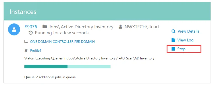

Stop
You can stop the job execution if needed.
Stop button
Click Stop to abort all instances in the job queue. The Stop link is only enabled while a job is running.
