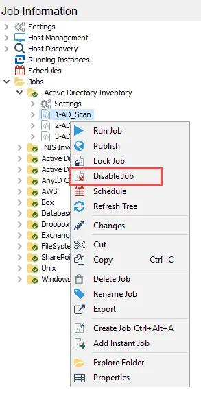

Step 1 – Select a job group or job.
When you disable jobs at the job group level, all jobs in the job group become disabled, but the job group itself remains enabled. Any additional jobs added to that job group later are enabled by default.
Disable Job from Jobs Tree
Step 2 – Right-click the job group or job and select Disable Jobs from the menu.

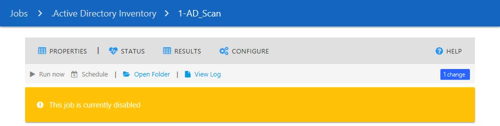

Disabled Job Description page banner
A yellow banner also notifies users that a job is disabled in the Job’s Description page.
Additionally, if you run a disabled job, a warning message appears in the Messages table stating: [UserName] requested [JobName] to run but it is in a disabled state. Job statistics also don't display on the job’s description page.

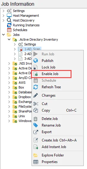

Step 1 – Select the disabled job. If multiple jobs in a job group are disabled, select the job group to enable all of the disabled jobs.
Enable Job from Jobs Tree
Step 2 – Right-click the job group or job and select Enable Jobs from the menu.
The job is now enabled. If you selected a job group, all the jobs in the group are now enabled.
