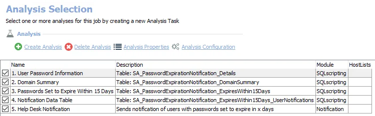

Analysis Tasks for the AD_PasswordExpirationNotification Job

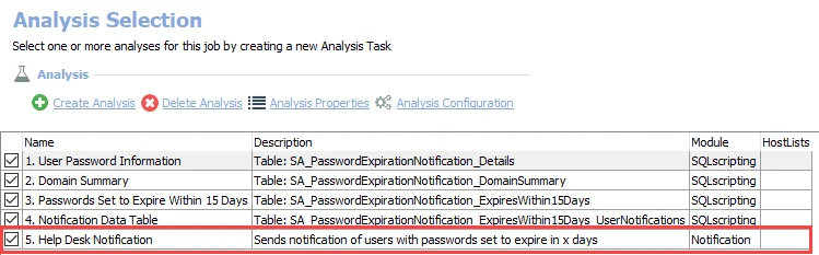

Navigate to the Jobs > AD_PasswordExpirationNotification > Configure node and select Analysis to view the analysis tasks.
- 1. User Password Information – Creates the PasswordExpirationNotification_Details table
accessible under the job’s Results node
- Contains a configurable parameter for the number of days until a password expires to be identified
- See the Customizable Analysis Tasks for the AD_PasswordExpirationNotification Job topic for additional information.
- 2. Domain Summary – Creates an interim processing table in the database for use by downstream analysis and report generation
- 3. Passwords Set to Expire Within 15 Days – Creates the PasswordExpirationNotification_ExpiresWithin15Days table accessible under the job’s Results node
- 4. Notification Data Table – Creates the PasswordExpirationNotification_ExpiresWithin15Days_UserNotifications table accessible under the job’s Results node
- 5. Help Desk Notification – Sends notification of users with passwords set to expire in X days
- See the Notification Analysis Task in the AD_PasswordExpirationNotification Job topic for additional information.

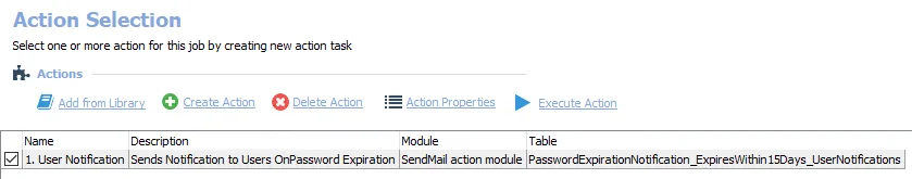

Navigate to the Jobs > AD_PasswordExpirationNotification > Configure node and select Actions to view the action modules.
This action is enabled by default.
The default actions are:
- 1. User Notification – Uses the SendMail Action Module to send notifications to users on
password expiration
- Requires the Notification Actions license feature
- See the Action Task in the AD_PasswordExpirationNotification Job topic for additional information.

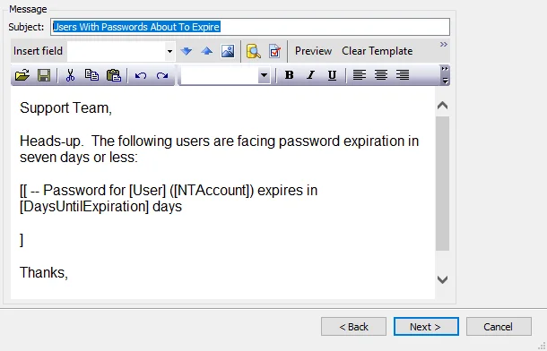

Use the Notification Analysis Task to send a single email to specified recipients containing a list of all users whose passwords will expire in the specified number of days, that is the users listed in the PasswordExpirationNotification_ExpiresWithin15Days table. The analysis is enabled by default. Therefore, when the job is executed the following message is sent to the specified recipient, such as the organization’s help desk, with information from the associated table:
Subject: Users with Passwords About To Expire
Support Team,
Heads-up. The following users are facing password expiration in seven days or less:
[ -- Password for [User] ([NTAccount]) expires in [DaysUntilExpiration] days]
Thank you,
Netwrix
Don't modify the tags, highlighted in bold text in the preceding message.
You can modify the Subject or message body, for example to replace Netwrix with the
organization’s name. To configure the 5. Help Desk Notification Analysis Task:
Step 1 – Navigate to the AD_PasswordExpirationNotification > Configure node and select Analysis to view the Analysis tasks.

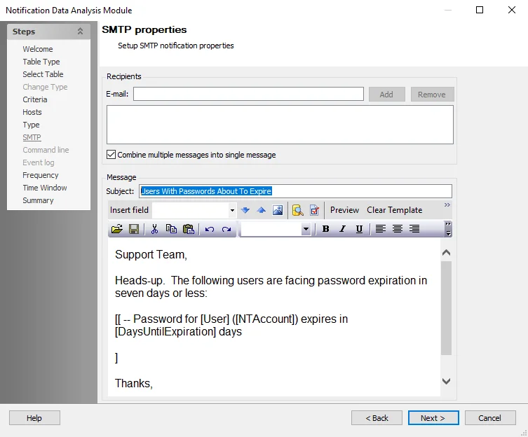

Step 2 – In the Analysis Selection view, select the 5. Help Desk Notification Analysis Task and click Analysis Configuration. The Notification Data Analysis Module opens.
Step 3 – Use the Next button to navigate to the SMTP properties page. Don't make changes to the preceding pages. The email configuration takes place on the SMTP page. Provide the recipients’ email addresses, Message Subject, and add the notification email content.
In the Recipients section, provide the email addresses in the text box or distribution lists in the E-mail field (fully qualified address) for those who are to receive this notification, for example the organization’s Help Desk. You can input multiple addresses by adding a semicolon (;) and space between entries.
Use the Add and Remove buttons to add or remove the address in the E-mail field from the Recipients list. There is an option to Combine multiple messages into single message, which is checked by default so that it sends one email for all users in the record set instead of one email per user.
In the Message section, configure the Subject. Then set the email content in the text box as desired.
Step 4 – To save these configuration changes, use the Next button to navigate to the Summary page. Don't make changes to any other pages. Click Finish. The Notification Data Analysis Module window closes.

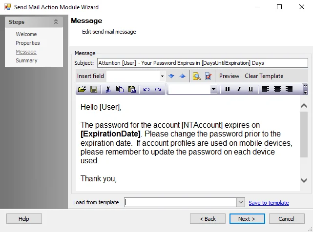

The 1. User Notification Action Task uses the SendMail Action Module to send users notification of password expiration. It targets the SMTP Address Column of the users whose passwords are going to expire within the number of days you want, that is the users listed in the PasswordExpirationNotification_ExpiresWithin15Days_UserNotifications table. The action is enabled by default. Therefore, when the job is executed the following message is sent to all users in the associated table:
Subject: Attention [User] - Your Password Expires in [DaysUntilExpiration] Days
Hello [User],
The password for the account [NTAccount] expires on [ExpirationDate]. change the password before the expiration date. If account profiles are used on mobile devices, remember to update the password on each device used.
Thank you,
Netwrix
Don't change the recipient for the action task. While you can move the tags, don't remove or modify them, which are highlighted in bold text in the preceding message.

Step 1 – Navigate to the AD_PasswordExpirationNotification > Configure node and select Actions.
Step 2 – In the Action Selection view, select the 1. User Notification Action Task and click on Action Properties to view the actions.
Don't modify the action task properties.
Step 3 – In the Action Properties view, the action properties and a preview of the users from the associated table appear. Click Configure Action. The Send Mail Action Module Wizard opens.
Step 4 – Click Next to navigate to the Message page. Modify the message Subject and email content as desired.
Step 5 – Click Next and then Finish to save the changes. The Send Mail Action Module Wizard closes.
