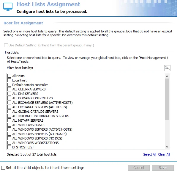

At the job group level, the Host Lists Assignment node identifies target host lists assigned for the job group.
Job Group Host Lists Assignment
At a top-level job group, there is no host list to be inherited. The Use Default Settings option is grayed-out. However, a sub-job group can inherit host lists from a parent job group. Host lists are configured through the Host Management node. See the Host Management topic for additional information.
Several pre-defined solutions have default host lists already assigned to the solution, for example the .Active Directory Inventory Job Group has the Default domain controller assigned at the job group and inherited to the jobs.
Select the host lists to be targeted by the job group. The Filter host lists by feature scopes the list to match the search string provided. At the bottom of the list is an indicator of how many hosts lists have been selected out of the total number of hosts lists known to the Enterprise Auditor Console. If a filter has been applied, there is also an indicator of how many host lists matched the search string.
Selecting the Set all the child objects to inherit these settings option forces inheritance of this setting to all sub-groups and jobs within the job group. When enabled, this option overrides any custom settings configured for the child objects.
