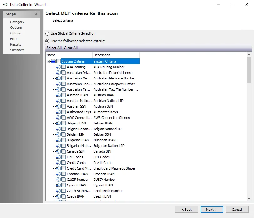

Use the Criteria page to configure the criteria for discovering sensitive data. It's a wizard page for the Sensitive Data Collection category.

SQL Data Collector Wizard Criteria page
The options on the Criteria page are:
  • Use Global Criterion Selection – Select this option to inherit sensitive data criteria settings from the Settings > Sensitive Data node. See the Sensitive Data topic for additional information.
  • Use the following selected criteria – Select this option to use the table to select which sensitive data criteria to scan for
    • Select All– Click Select All to enable all sensitive data criteria for scanning
    • Clear All – Click Clear All to remove all selections from the table
    • Select the checkboxes next to the sensitive data criteria options to enable the query to scan for them during job execution
The table contains the following types of criteria:
Until the Sensitive Data Discovery Add-On is installed, only the headers for the System Criteria and User Criteria nodes are visible in the table.
  • System Criteria – Lists pre-defined criteria
  • User Criteria – Lists user-defined criteria
    Use the Sensitive Data Criteria Editor in the Settings > Sensitive Data to create and edit user-defined criteria. See the Sensitive Data Criteria Editor topic for additional information.
Adding unnecessary criteria can adversely impact the scanner performance and can cause the scanning job to take a long time. If unnecessary criteria adversely affect performance, revisit the sensitive data scanning criteria and remove criteria that isn't required.
