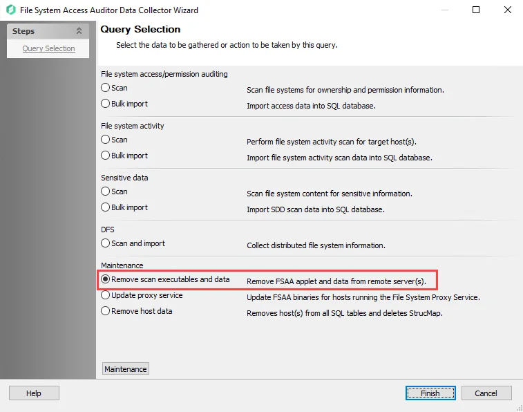

Remove File System Access Scan Category
Use the FSAA Data Collector to clean up or troubleshoot the applet and proxy scanning servers. This would need to be done through a new job’s query. Set the host list and Connection Profile to target the applet and proxy servers you want.
To build a new query using the FSAA Data Collector with the Remove scan executables and data category:
Step 1 – Navigate to the Configure node of a new or chosen job and select the Queries node.
Step 2 – In the Query Selection view, click the Create Query link. The Query Properties window displays.
Step 3 – Select the Data Source tab. From the Data Collector dropdown menu, select FILESYSTEMACCESS and then click the Configure button. The File System Access Auditor Data Collector Wizard opens.
FSAA Data Collector Wizard Query Selection page with Remove scan executables and data option selected
Step 4 – On the Query Selection page, select the Remove scan executables and data category.
Step 5 – Click Finish to save the selection and close the wizard. Then click OK to close the Query Properties window.
This job has now been configured to run the FSAA Data Collector to remove the file system access audit scan applet and data from the target server. Run the job to clean-up the targeted hosts.

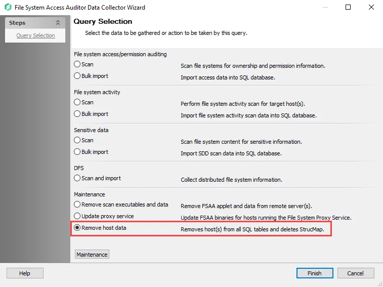

Remove Host Category
Use the FSAA Data Collector to clean up the Standard Reference Tables by removing data for particular hosts. This would need to be done through a new job’s query. The host to be removed is set as the host list for the new job. The Connection Profile applied should be the same as the one used for the associated FileSystem > 0.Collection > … Bulk Import Job.
Be careful when applying this query task, as it results in the deletion of collected data. Ensure proper configuration before job execution.
info
Manually enter individual hosts into the host list executing this query.
To build a new query using the FSAA Data Collector with the Remove host data category:
Step 3 – Select the Data Source tab. From the Data Collector dropdown menu, select FILESYSTEMACCESS and then click Configure. The File System Access Auditor Data Collector Wizard opens.
FSAA Data Collector Wizard Query Selection page with Remove host data option selected
Step 4 – On the Query Selection page, select the Remove host data category.
This job has now been configured to run the FSAA Data Collector to remove the host identified in the job’s Configure > Hosts node. Run the job to clean-up the targeted hosts.

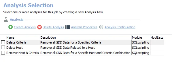

The FS_SDD_DELETE job removes host and criteria sensitive data matches from the Tier 1 database. It is preconfigured to run analysis tasks with temporary tables that requires modification before job execution. It is available through the Instant Job Library under the File System library. See the Instant Job Wizard topic for additional information.
FS_SDD_DELETE Job in Job's Tree
The 0.Collection Job Group must be run before executing the FS_SDD_DELETE Job.
Analysis Tasks for the FS_SDD_DELETE Job
The analysis tasks are deselected by default. View the analysis tasks by navigating to the Jobs > FS_SDD_DELETE > Configure node and select Analysis.
Applying these analysis tasks result in the deletion of collected data.
FS_SDD_DELETE Job Analysis Selection page
  • Delete Criteria – Remove all SDD Data for a Specified Criteria
  • Delete Host – Remove all SDD Data Related to a Host
  • Remove Host & Criteria – Remove all SDD Data for a Specific Host and Criteria Combination

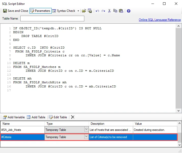

Customizable Analysis Parameters for FS_SDD_DELETE Job
A customizable parameter enables Enterprise Auditor users to set the sensitive data values that will be deleted during this job’s analysis.
Analysis TaskCustomizable Parameter NameValue Indicates
Delete Host#hostsList of Host Names to be removed
Delete Criteria#CriteriaList of Criteria to be removed
Remove Host & Criteria#Criteria #hostsList of Criteria and Host Names to be removed
The parameters that can be customized are listed in a section at the bottom of the SQL Script Editor. To customize analysis task parameters:
Step 1 – Navigate to the FS_SDD_DELETE > Configure node and select Analysis.
Step 2 – In the Analysis Selection view, select the analysis task you want and click Analysis Configuration. The SQL Script Editor opens.
 FS_SDD_DELETE Job Analysis Task in SQL Script Editor
Step 3 – In the Parameters section at the bottom of the editor, select either the #Criteria or #hosts row, depending on the analysis task chosen, and then Edit Table. The Edit Table window opens.
Don't change any parameters where the Value states Created during execution.
SQL Script Editor Edit Table window
Step 4 – Use the Add New Item button to enter host names or criteria to the temporary table list manually, or select the Browse button to upload a list of hosts in CSV format. Click OK to save any changes. Other Edit Table buttons include:
  • Edit a Value
  • Delete this row/column
  • Move up
  • Move down
Step 5 – Click Save and Close to finalize the customization and close the SQL Script Editor.
The job is now ready to be executed.

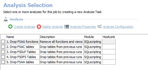

Drop Tables & Views
If it becomes necessary to clear the FSAA Data Collector tables and views to resolve an issue, the FS_DropTables Job is preconfigured to run analysis tasks that drop functions and views for the File System Solution as well as the standard tables and views generated by the FSAA Data Collector.
It is available through the Instant Job Library under the File System library. Since this job does not require a host to target, select Local host on the Hosts page of the Instant Job Wizard. See the Instant Job Wizard topic for additional information.
FS_DropTables Job in Job's Tree
The 0.Collection Job Group must be run before executing the FS_DropTables Job.
Analysis Tasks for the FS_DropTables Job
The analysis tasks are deselected by default. View the analysis tasks by navigating to the Jobs > FS_DropTables > Configure node and select Analysis.
FS_DropTables Job Analysis Selection page
  • 1. Drop FSAA functions – Removes all functions and views from previous runs of the File System Solution
  • 2. Drop FSAC tables – Drops the File System Activity Auditing tables imported from the previous runs
  • 3. Drop FSDLP Tables – Drops the File System Sensitive Data Discovery Auditing tables imported from the previous runs
  • 4. Drop FSDFS Tables – Drops the File System DFS Auditing tables imported from the previous runs
  • 5. Drop FSAA Tables – Drops File System Access Auditing tables imported from the previous runs
Don't try to run these tasks separately, as they are designed to work together. Follow these steps to run the analysis tasks:
Step 1 – In the Analysis Selection Pane, click Select All. All tasks will be checked.
Step 2 – Right-click the FS_DropTables Job and select Run Job. The analysis execution status is visible from the Running Job node.
Step 3 – When the job has completed, return to the Analysis Selection Pane and click Select All to deselect these analysis tasks.
Don't leave these analysis tasks checked to avoid accidental data loss.
All of these tables have been dropped from the SQL Server database and the data is no longer available.
