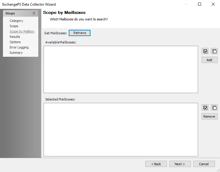

ExchangePS Data Collector Wizard Scope by Mailboxes page
Click Retrieve to return all mailboxes in the Exchange Organization and populate them in the Available Mailboxes list. Select desired mailboxes from the Available Mailboxes list and click Add. The wizard adds the selected mailboxes to the Selected Mailboxes list. To remove undesired mailboxes from Selected Mailboxes, select them and click Remove. The Select All and Clear All buttons let you select quickly.
