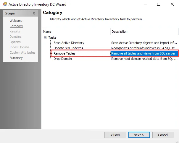

Remove Tables task selected on Active Directory Inventory DC Wizard Category page
Step 2 – In the Active Directory Inventory DC Wizard on the Category page, select the Remove Tables category task.
