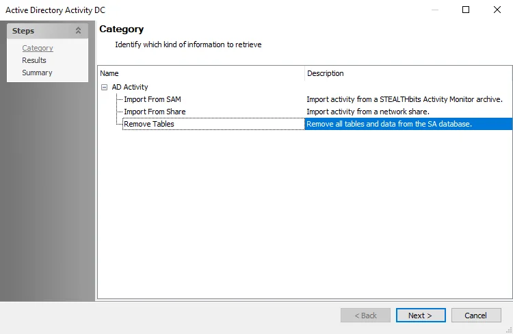

Step 2 – In the Active Directory Activity DC Wizard on the Category page, select the Remove Tables category task.

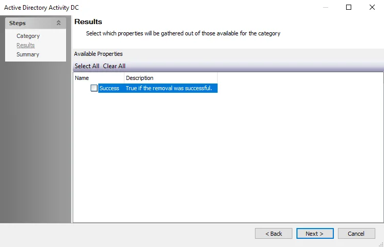

Step 3 – Click Next to go to the Results page. Optionally, select the Success checkbox to display a confirmation of successful removal in the results after you run the job.
