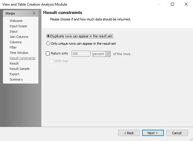

Use the Result Constraints page to impose restraints on the dataset.
View and Table Creation Analysis Module wizard Result constraints page
Select one of the following options to choose whether and how much data to return:
  • Duplicate rows can appear in the result set
  • Only unique rows can appear in the result set
  • Return only [number] [unit] of the rows – Select this checkbox to specify a numeric value and unit of measurement to return for the rows that appear in the resulting table or view
    • With ties – Include all instances of identical values in the sorted columns with the results. To include only one instance of identical values, don't select this option.. See the With Ties Example topic for additional information.
      This field is enabled by sorting at least one column in the table by value (for SQL, only a sorted column can contain ties). To sort columns, use the Order By Operation field on the Columns page. See the SQLViewCreations: Columns topic for additional information.
