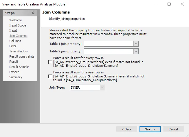

Use the Join Columns page to select a column from each source table to join together on the resulting table or view. Enterprise Auditor enables the options on this page only if you select two tables on the Input Source page.
The SQLViewCreation analysis module can join two tables, using a simple equi-join condition of two predicates. For composite joins with two or more tables using a conjunction of predicates, use the SQLscripting analysis module. See the SQLscripting Analysis Module topic for additional information.
View and Table Creation Analysis Module wizard Join Columns page
Use the Table 1 join property and Table 2 join property fields to select join predicates from both tables. Join predicates are columns containing analogous values that match records in referenced tables.
Next, specify how to join these tables. To automatically select the appropriate join type, select one or more of the checkboxes. The selection in the Join Type field updates based on user selections.
To manually select, use the Join Type field. The selection here may update the checkboxes you selected earlier. The following options are available:

The join property is the column found within both tables. The two columns can have different names. However, in the results set, wherever a value in the first column matches the value in the second column, Enterprise Auditor joins rows from the respective tables.
After selecting a column from each data source to join, click Next to select columns to transfer to the resulting table or view.
