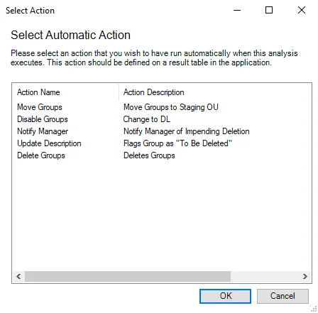

Select Action Window
The Select Action window lists the actions that exist within the Job that you can select to automatically run upon job execution.
Select an action from the list. Click OK to exit the window, and then click Save to preserve the changes made to the analysis module. The action now executes as part of the analysis task. If you selected no actions, click Cancel instead to close the Select Action window without saving accidental selections. Actions only display if they exist within the Actions node of the current Job.
