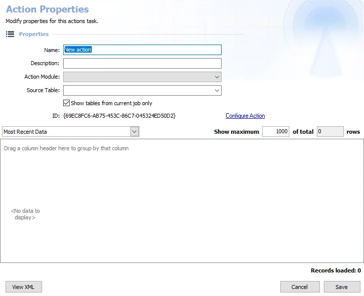

Action Properties Page
Use this page to view or specify properties for a selected action, including the name, description, action module, and source table. Access this page via the Action Selection view.
Action Properties page for new action
info
Provide unique and descriptive names and action task descriptions to all user created action tasks.
  • Name – Action task name. For new actions, an editable default name displays.
  • Description – Action task description. For new actions, this editable field is blank.
  • Action Module – dropdown menu of available action modules
    • Configure Action – Opens the configuration wizard for the selected action module
  • Source Table – Table with objects the action task acts upon. For new actions, this field is blank. Specify a source table on which to perform the action.
  • Show tables from current job only – Restricts the list of source tables available to only those tables generated by the job where the action task resides. Deselect the checkbox to list all available data tables.
  • ID – Unique identifier, or GUID, of the action task generated by the application. With this ID, the database can distinguish actions, even those with identical configurations.
  • Data Grid – Displays a sample of the selected Source table. This data grid functions the same as all data grids within Enterprise Auditor. You can filter data and regroup columns. See the Data Grid Functionality topic for additional information.
