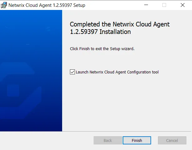

Step 4 – Complete the Install the Agent steps. Ensure you tick Launch Netwrix Cloud Agent Configuration tool and click Finish.

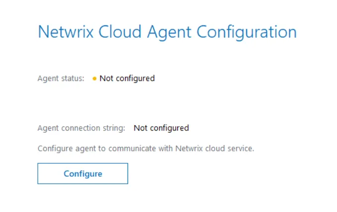

Step 5 – On the displayed Netwrix Cloud Agent Configuration screen, select Configure to configure with Netwrix Cloud Agent.

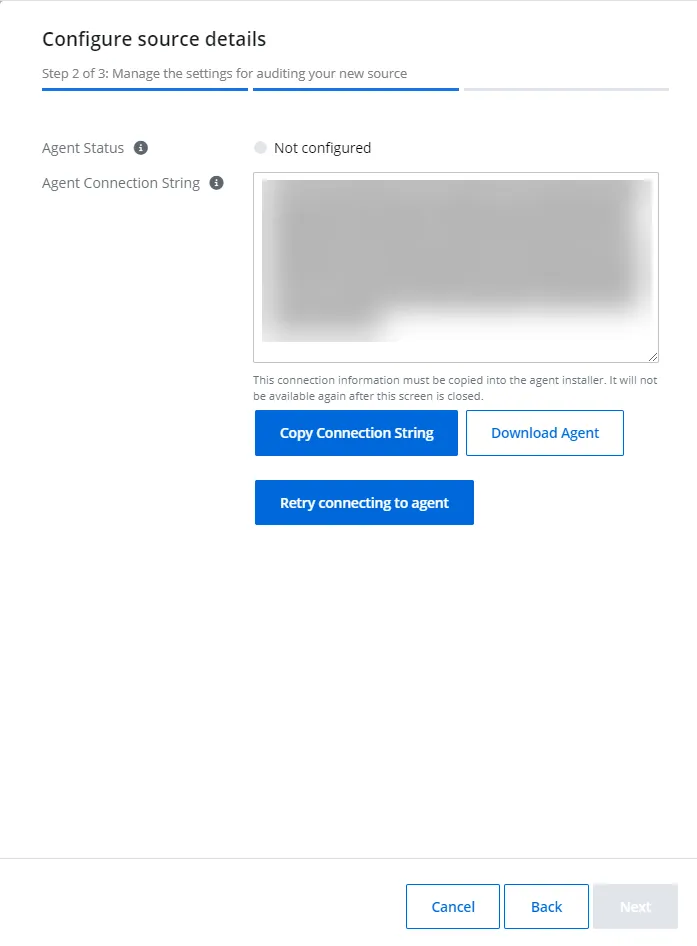

Step 6 – Go back to your Netwrix 1Secure configuration panel and copy the agent connection details by selecting Copy Connection String. This information will be used for agent deployment.

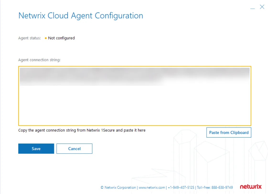

Step 7 – Paste the information in the Netwrix Cloud Agent Configuration that you copied earlier and save settings.
The agent status has changed to Connected (green).
Step 8 – Go back to the Netwrix 1Secure configuration panel and select Retry connecting to the client. The agent status shall change to Healthy.

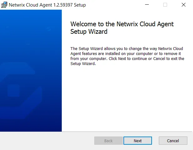

Step 3 – Click Next to continue.

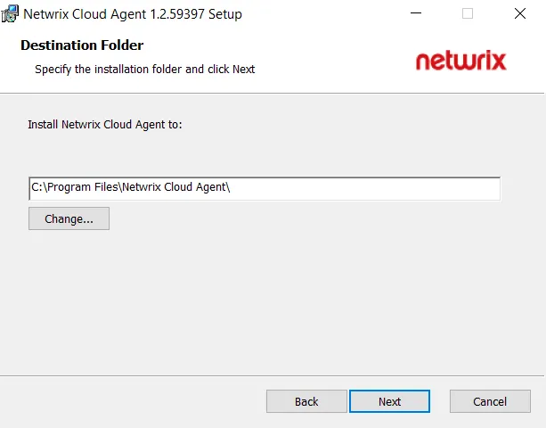

Step 4 – Specify the installation folder and click Next to continue.

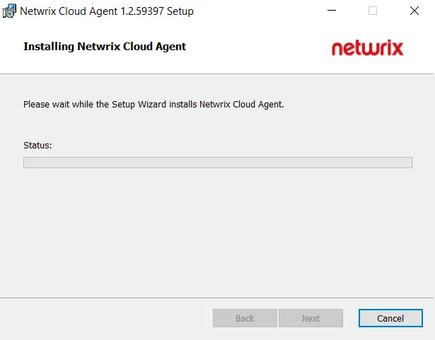

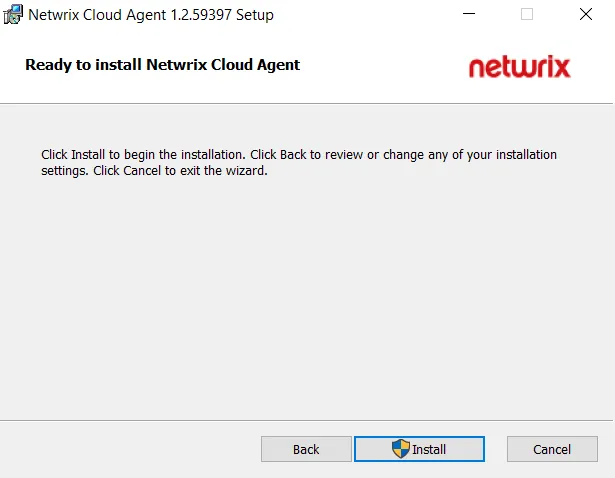

Step 5 – Click Install. The agent starts the installation process.
Step 6 – Keep the Launch Netwrix Cloud Agent Configuration tool checkbox selected and click Finish to complete the setup.
