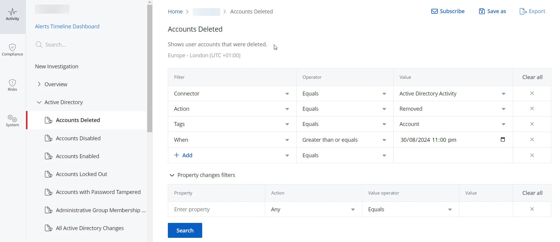

Follow the steps to apply filters to your search.
Step 1 – Select the Reports> Activity tab.

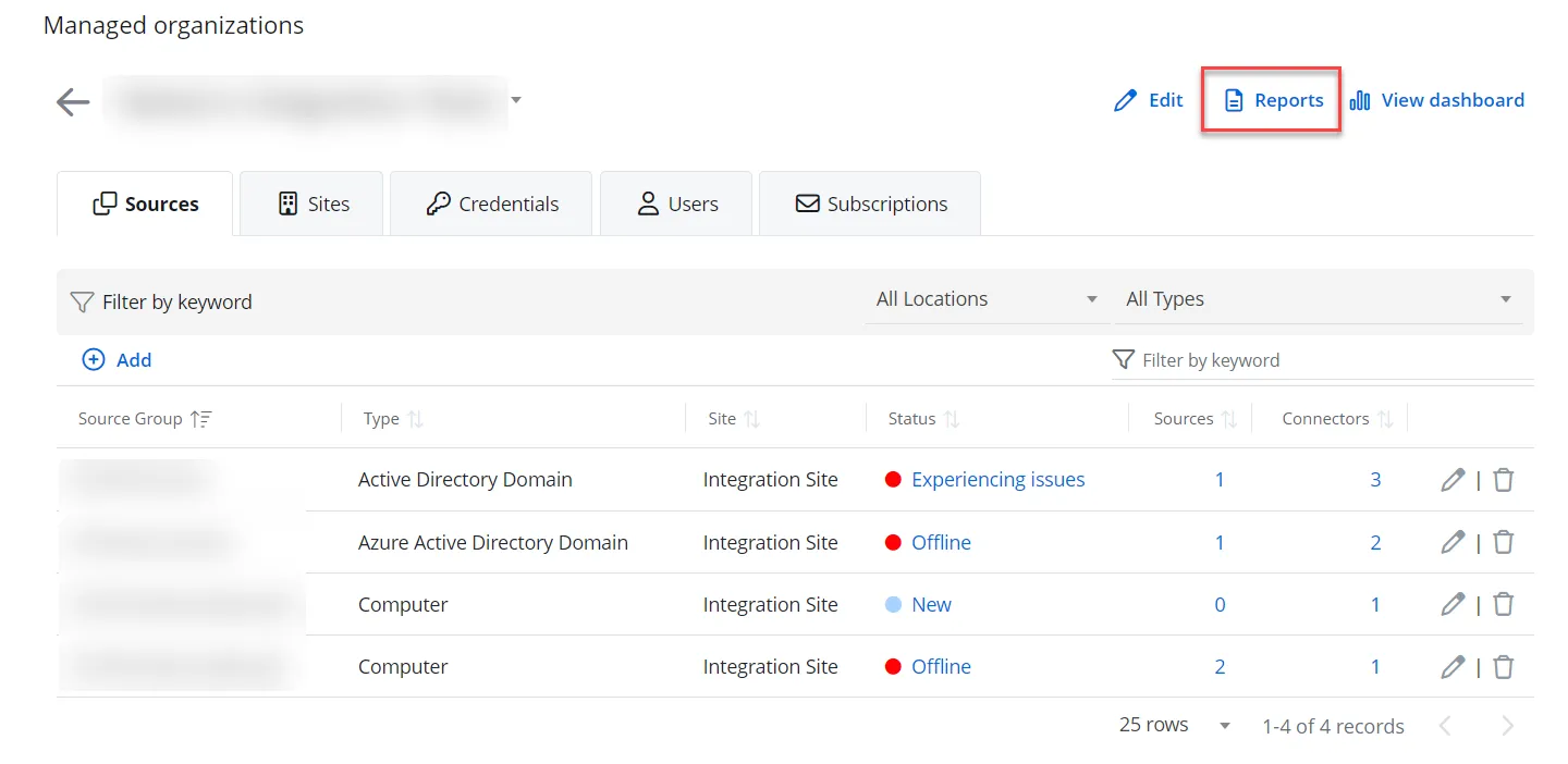

You can also access the Reports > Activity page from your organization's page. On your Home screen, click Configure > Reports in the right upper corner of the page.

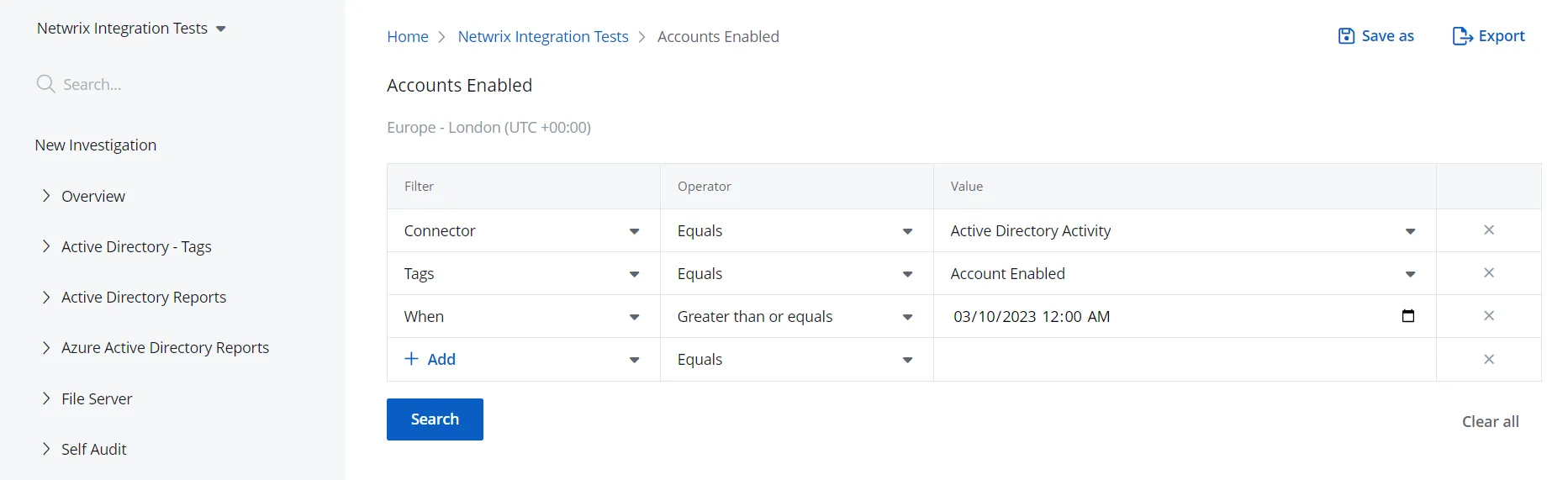

Step 2 – Select a filter from the Filter drop-down menu. See the Filter Descriptions topic for additional information.
You must specify three columns: Filter, Operator, and Value. You may also select more than one filter. To review the Operator filter options, see the Filter Operators topic for additional information. To review the Filter values, see the Filter Values topic for additional information.

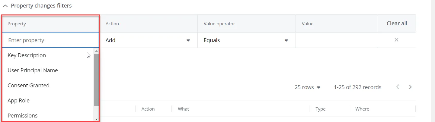

Step 3 – If required, specify the property change filters.
Netwrix 1Secure comes with the advanced filtering options. Not all the activity records have the property changes, but only those with the property change on that record. For example, if the permission on the Active Directory has been added or resource ID in AzureAD has been removed.
The drop-down list in the Property field shows all the properties retrieved in your records' list below the Search bar. It varies depending on the displayed records. You can filter the required Property, Action, Value operator, and Value within the list. The property changes are dynamic and are not related to a given report directly but the activity records. If the query changes, the shown property changes may also change.

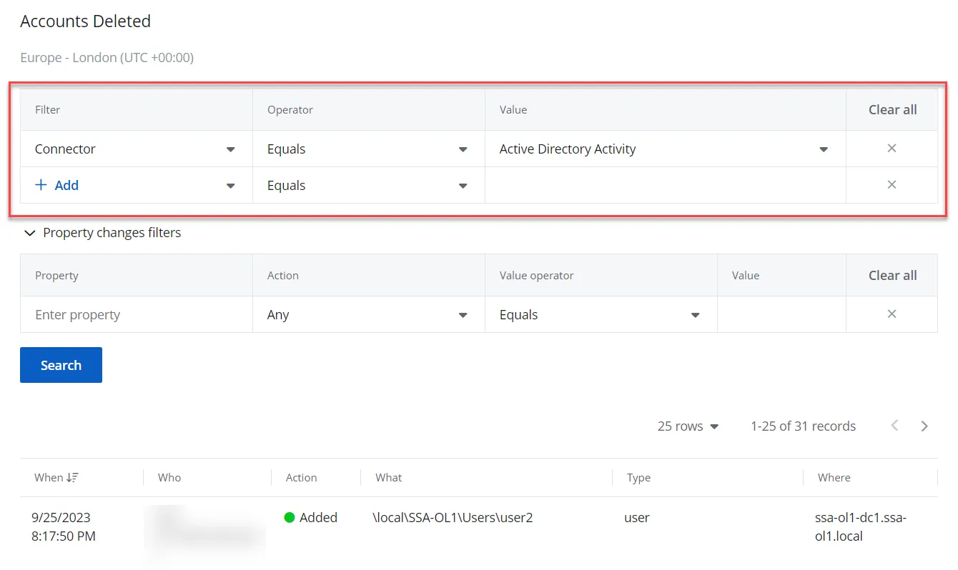

Step 4 – Click Search to find and view your reports. The reports are displayed with the predefined filters. Your search results will display in the table.

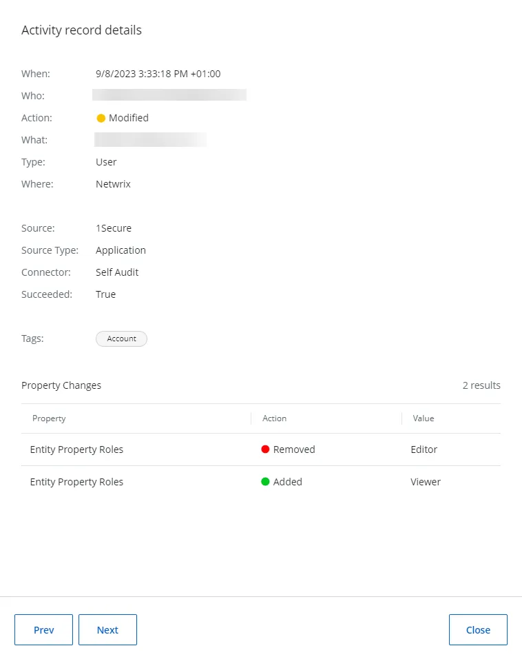

Step 5 – Click the required activity record from the grid view the activity record details. You can see who, when, or where was the activity made.
Navigate from one report to another by selecting Prev or Next. This will directly upload the details of the selected report.
