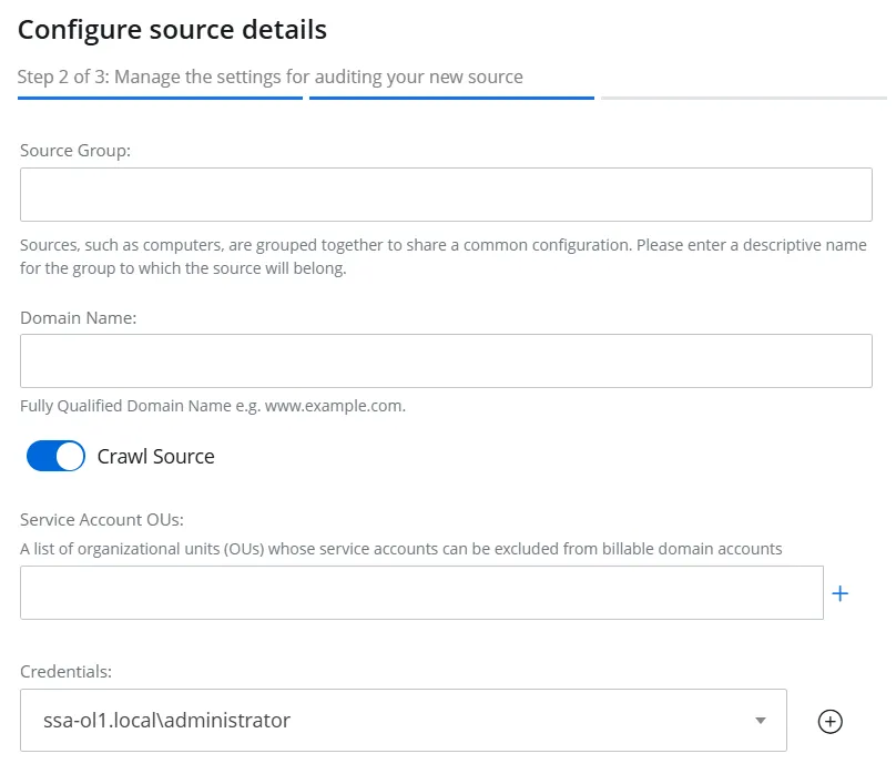

Step 7 – Specify the following settings:
Source Group – Specify a name for the group to which the data source will belong. Grouping sources, such as computers, allows them to share a common configuration and makes it easier to manage related sources together.
Domain Name – Specify the fully qualified domain name of the Active Directory domain you want to create a source for.
Crawl Source – Toggle this option to ON to enable data collection for the source.
Service Account OUs – Specify organizational units (OUs) to exclude their service accounts from billable domain accounts so that they are not audited. To specify an organizational unit (OU), enter its name and click the Add icon. To specify multiple organizational units, add them one by one.
Credentials – Displays the crdentials that have already been added, while also providing the option to add new credentials. Netwrix 1Secure uses these credentials to connect to the data source. You can select existing credentials or add new ones. To add new credentials, select Add new Credentials from the drop-down menu or click the Add icon, then specify the following:
- Username – The username of an Active Directory account in Domain\Username format
- Password – The password of the Active Directory account
- Display Name – Specify a name you want to show for your credentials. It will be displayed on the Credentials tab of the Managed Organizations page.

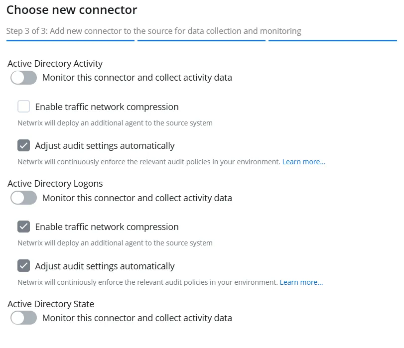

Step 9 – The Choose new connector (Step 3 of 3) pane lists three connectors for Active Directory. Specufy the following:
- Active Directory Activity – Toggle the Active Directory Activity switch to ON to collect and monitor data for this connector. With this, you can generate activity reports on Active Directory data. See the Active Directory topic for additional information.
- Activity Directory Logons – Toggle the Active Directory Logons switch to ON to collect and monitor data for this connector. With this, you can generate logon reports on Active Directory data. See the Active Directory topic for additional information.
- Activity Directory State – Toggle the Active Directory State switch to ON to collect and monitor data for this connector. With this, you can generate state-in-time reports on Active Directory data. See the State In Time Risks Reports topic for additional information.
- Ping Castle - Toggle the Ping Castle switch to ON to collect data for this connector. With this, you can generate risks from the Ping Castle collector and generate the full PingCastle report.
Step 10 – Optionally, select the following for each connector:
Enable traffic network compression – Select this checkbox to enable traffic network compression for the connector. See the Network Traffic Compression topic for additional information.
warningIf Netwrix Auditor and Netwrix 1Secure audit the same domain, make sure that the network traffic compression service is enabled for only one of the products or neither product for any of the audited services. It cannot be enabled for both products.
Adjust audit settings automatically – Select this checkbox to adjust the audit settings automatically. With this approach, 1Secure will check your current audit settings at each data collection session and adjust them if necessary. See the Active Directory: automatic configuration topic for additional information.
