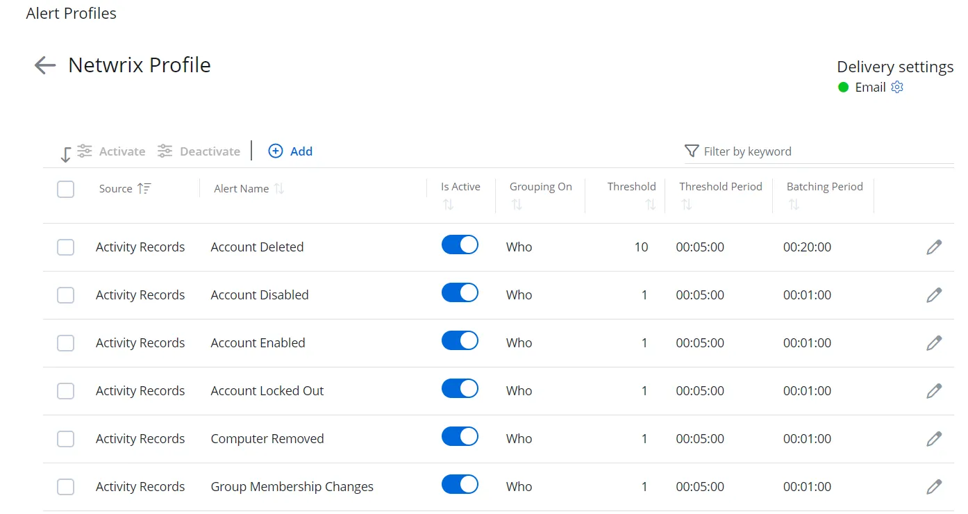

Follow the steps to view the alerts within an alert profile.
Step 1 – Navigate to Configuration > Alerts.
Step 2 – Click an alert profile. The alerts for the profile are displayed in a list.
You can view the following for each alert in the list:
- Source – Indicates the origin or type of data that triggers the alert. For example, Activity Records.
- Alert Name – The name of the alert
- Is Active – Indicates whether the alert is activated. You can toggle it ON or OFF as required.
- Grouping On – Indicates whether grouping is applied to the alert. If yes, then it displays the criteria, such as What, Who, Where, etc.
- Threshold – The threshold value set for the alert. The threshold is the minimum number of activity records that must occur within a specified time frame (threshold period) to trigger an alert.
- Threshold Period – The threshold period set for the alert. The threshold period is the maximum duration, starting from the first activity record, within which the specified number of activity records (threshold) must occur to trigger an alert.
- Batching Period – The batching period set for the alert. The batching period feature allows you to receive a single notification that includes all alerts triggered during the specified period.

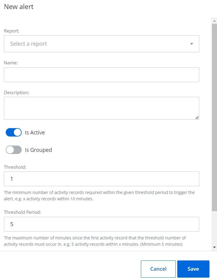

Step 3 – Click Add. The New Alert pane is displayed.
Step 4 – Select a custom report from the Report drop-down menu to trigger the alert when a new record is generated for the report. See the Custom Reports topic for additional information.
Step 5 – Specify a name and description for the alert.
Step 6 – Toggle the Is Active switch to ON to activate the alert. Notifications are sent for active alerts only.
Step 7 – Toggle the Is Grouped switch to ON, which displays the Grouped On drop-down menu. When grouping is enabled, alerts are organized based on the criteria you select in the Grouped On drop-down menu.
Step 8 – Select one of the following options from the Grouped On drop-down menu:
- Who – Groups alerts with respect to the user who performed the activity (deleted an account, created a record, etc.)
- Where – Groups alerts with respect to the location where the activity is performed. For example, SharePoint Online site, file server, etc.
- What – Groups alerts with respect to the object the activity is performed on, such as a computer, file, etc.
Example: You have two users, User 1 and User 2, each performing different actions. By setting "Grouped On" to "Who", alerts will be generated per user, resulting in two separate alerts — one for User 1 and another for User 2. Each alert will include only the activity associated with that specific user. If grouping is not enabled, all activities will be consolidated into a single alert based on the specified threshold and threshold period.
Step 9 – In the Threshold field, specify a threshold for the alert. The threshold is the minimum number of activity records that must occur within a specified time frame (threshold period) to trigger an alert. For example, if the threshold is set to 3, an alert will be triggered when at least 3 activity records are generated within the specified time frame.
Step 10 – In the Threshold Period field, specify a threshold period for the alert. The threshold period is the maximum duration, starting from the first activity record, within which the specified number of activity records (threshold) must occur to trigger an alert. For example, if the threshold is set to 5 and the threshold period is 10 minutes, at least 5 activity records must be generated within 10 minutes to trigger an alert.
Step 11 – If you do not want alert notifications to be sent to you each time an alert is generated, there is a batching period option. In the Batching Period field, specify a batching period for the alert. The batching period feature allows you to receive a single notification that includes all alerts triggered during the specified period. For example, if the batching period is set to 30 minutes (00:30:00) for an alert such as "Computer removed," you will receive a single notification for the alerts generated during that time frame, rather than receiving individual notifications for each alert.
Step 12 – Click Save.
The alert is configured and added to the list.
